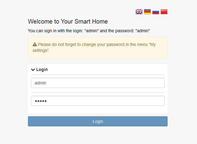

  1. Open in your browser Z-Way user interface using URL http://IP:8083/ and log in

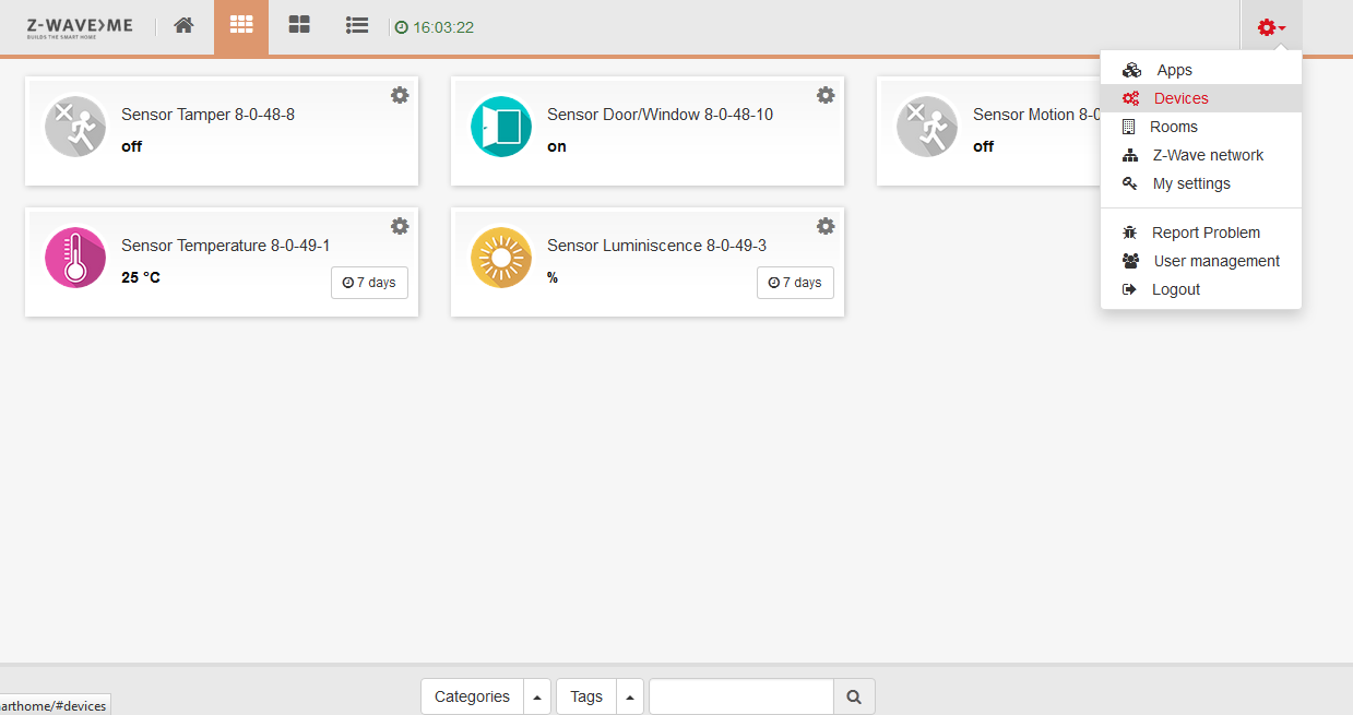

  2. Go to Settings (Gear sign) → Devices

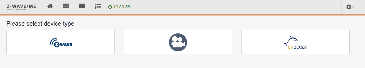

  3. Press on Z-Wave logo

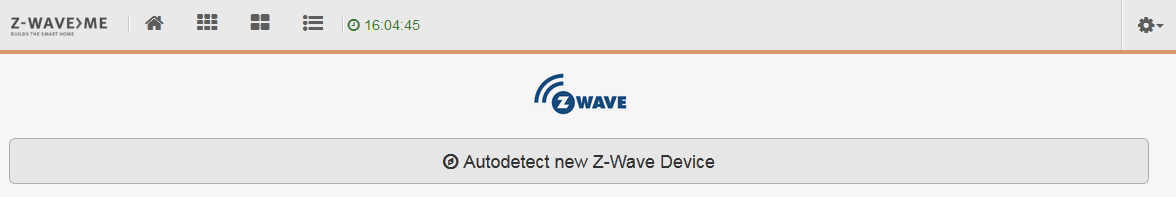

  4. Select «Autodetect new Z-Wave Device» or choose Z-Wave.Me → Z-Uno

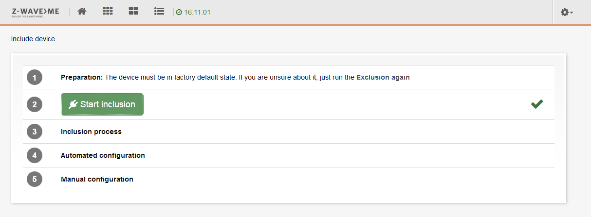

  5. Press «Start inclusion» button and press three times Service button on Z-Uno
  6. Congratulations! Now you can control your Z-Uno and gather sensor information from it
