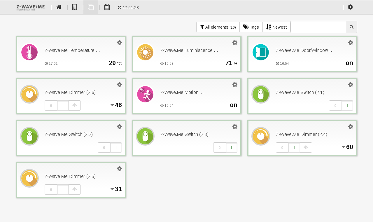

10 Channels Certified Sketch
![](/files/Z-WavePlusProduct_200.png)
As an example motion sensor switches on/off devices in association group #2. Z-Uno 2 certified example is locate here.
Download Fritzing project
* This scretch was certified by the Z-Wave Alliance as one of the two reference Z-Uno sketches.
* 3 switches
* 3 dimmers
* 1 motion sensor
* 1 temperature sensor
* 1 luminance sensor
* 1 door sensor
