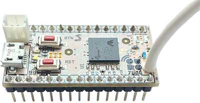

1 Z-Wave plate Z-Uno 59.49€

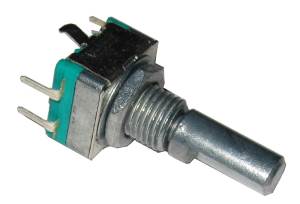

3 Encoder EC11 1€
Schematic for LED Controller very simply. The encoder is connected by three pin. Button pin 23 using to add device to Z-Wave network by tree times push. MOSFET connected to PWM1 pin, like a build-in LED. Source code contain 143 lines. Every 128 μs by interrupt from GPT timer in gpt_handler() checking in which direction the wheel is spinning. In loop caught a button press. If button pressed LED strip turn off or restore previos brigthness level.
