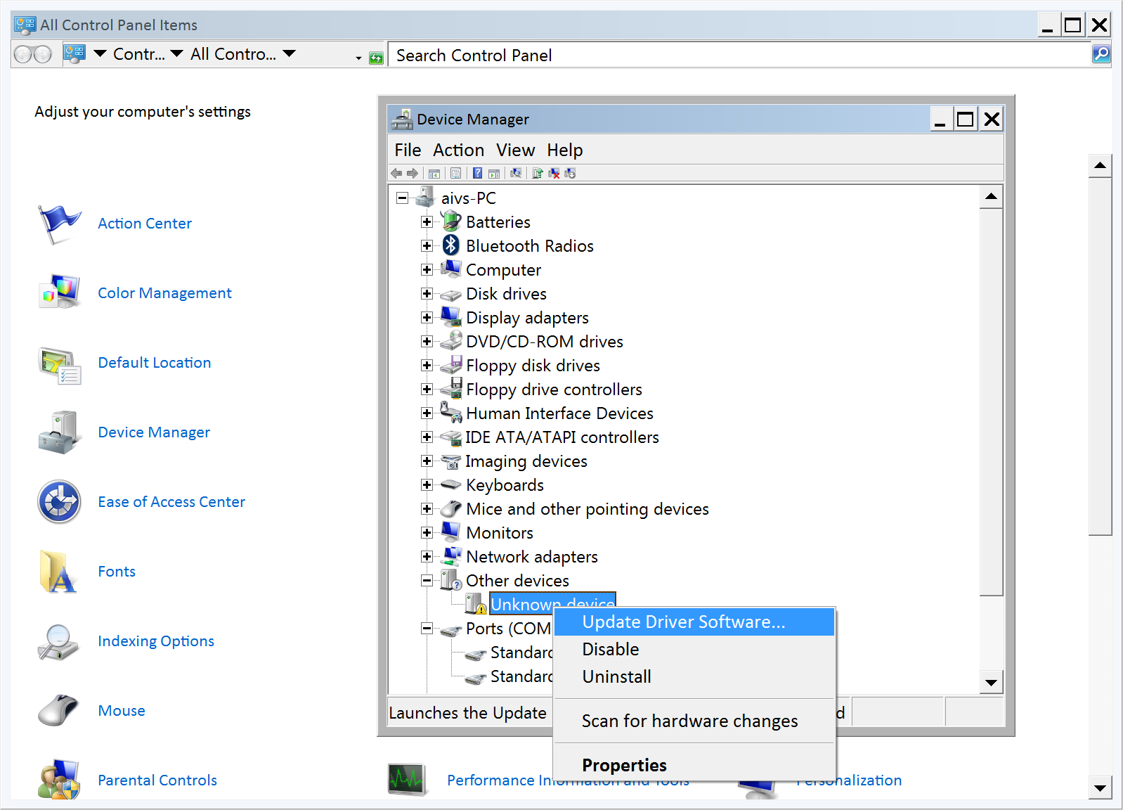

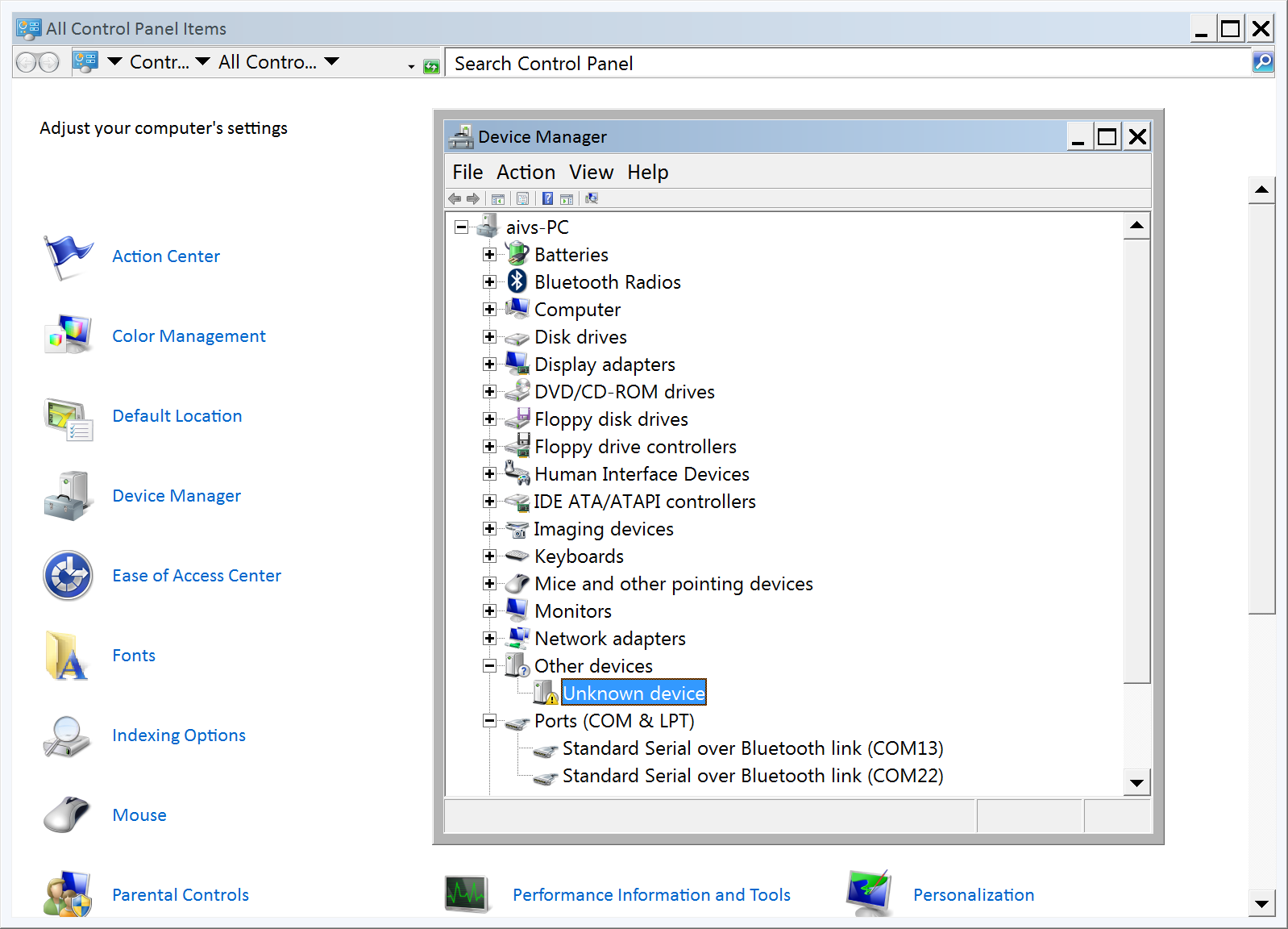

  3. Open "Control Panel->Device Manager"
  4. Select "Unknown device"
  5. Press right mouse button on "Unknown device" and select "Update Driver Software ..."

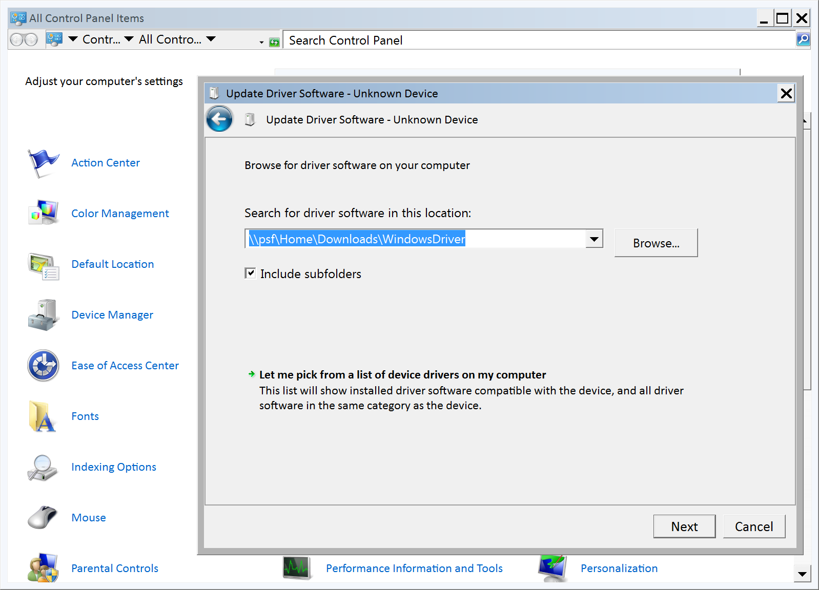

  6. Press "Browse my computer for driver software"
  7. Browse folder with Z-Uno driver

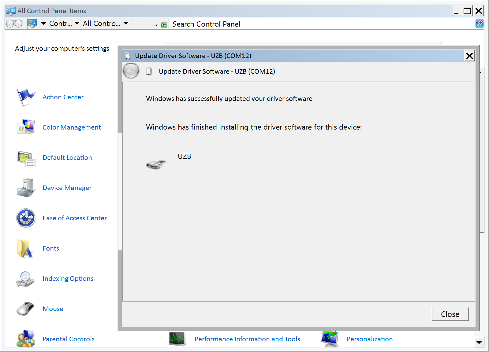

  8. Driver installed successfully
  9. New COM port appeared
Now you can use your Z-Uno in Arduino IDE!
